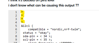

  • I have a feeling that your overlay file is not working properly.
    Also, I just noticed that four rows with '*' in the file nrf5340dk_nrf5340_cpuapp.dts.pre.tmp in your build folder.
    Is this something you added? Or do you perhaps have some remains of old comments in your overlay file? Perhaps cleaning up the overlay file will work?
    In your text editor, are you able to see these lines grayed out? If your device tree(and configs) is set up properly you should see something like the image below (This method might not be 100% accurate, though it could help indicate when something is wrong.)
  • yes when my config was right i used to have the line just like the image you posted
    and speaking about my overlay file it looks just like this
    &i2c1 {
    	status = "okay";
    	sda-pin = < 34 >;
    	scl-pin = < 35 >;
        clock-frequency = <100000>;
    	/* The I2C address could be one of two, here 0x76 is assumed */
    	bme280@76 {
    		compatible = "bosch,bme280";
    		reg = <0x76>;
    		label = "BME280";
    &uart1 {
        status = "disabled";
    the stars i putted the when i posted my question to make it easy for you to stop the right line ( i said "the line 698 in the nrf5340dk_nrf5340_cpuapp.dts.pre.tmp is the line 8 below and so on")
    so my overlay was good from the beginning

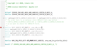

  • in fact the error that i posted is related to this file and exactly to the bloc in grey on nvic.h file
    "  C:/Users/rzaafouri/ncs/v1.5.1/zephyr/include/arch/arm/aarch32/cortex_m/nvic.h:15:44: error: pasting ")" and "_P_arm_num_irq_priority_bits" does not give a valid preprocessing token  "
    C:/Users/rzaafouri/ncs/v1.5.1/zephyr/include/arch/arm/aarch32/cortex_m/nvic.h:15:32: error: 'arm_v8m_nvic' undeclared (first use in this function)
     C:/Users/rzaafouri/ncs/v1.5.1/zephyr/include/devicetree.h:463:48: error: expected ')' before '_P_arm_num_irq_priority_bits'
    C:/Users/rzaafouri/ncs/v1.5.1/zephyr/include/arch/arm/aarch32/exc.h:24:36: note: to match this '('
    1> C:/Users/rzaafouri/ncs/v1.5.1/zephyr/include/arch/arm/aarch32/cortex_m/nvic.h:15:28: error: missing binary operator before token "("
    i'm getting these couple of errors do you know if there's a link between them
    because my error is certainly a processing error
    can you help with this please
    knowing that i just tried to open another project from a different directory then the BME280 project
    it went all on collapse !
    can you please help me please
     i really need help

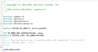

  • Hello Helsing,
    i succeeded to resolve the error of processing
    i reinstalled the SDK and the toolchain manager
    i reconfigured my environment
    and then i got to deal with the device tree issue so i putted the pin config aka this one
    &i2c1 {
     status = "okay";
     sda-pin = < 34 >;
     scl-pin = < 35 >;
     bme280@76 {
      reg = <0x76>;
      label = "BME280";
    &uart1 {
    on the overlay file "nrf5340dk_nrf5340_cpuapp.overlay"
    and the build was successful
  • Hello Helsing,
    the error related to the devicetree could be resolved by putting all the project substances in the same version of SDK
    the building is breakable if the main and the nrf**.overlay are not on the same version
    thank you for your help
