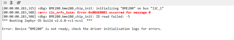

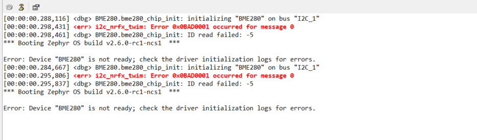

    i'm recently having an issue with the display of the values of the BME280
    well it's displaying this error when the sensor is connected to the Kit
    and it's displaying this error with the other address when it's not connected
    Knowing that :
    0x0BAD0001 means "Internal Error" in the I2C driver.
    0x0BAE0001 means "Address not acknowledged" in the I2C driver.
    and doubting that the issue is hardware that leads me to believe that the issue may be with how the sensor is wired to the board, or setup in some way, causing an error in the driver.
    for me i did the wiring like this
    P1.02 to SDI
    P1.03 to SCK
    GND to SDO
    GND to GND
    Vin 3-5v to VIN
    is there a pre-config to do or some settings to fix before running the sensor ?
    can you please help me with the wiring
    knowing that you already tried the sensor, how did it go with you please ?
    can you help me please
    i would be very grateful
  • the final answer for the display of this problem was related to the voltage
    try to double check with a voltage meter that the input voltage is 3V
    Find a pin labeled "VDD", and try that if you measure it to be 3.3V.
    in this case the needed voltage is 3.3V
    make sure your pins wiring is good
