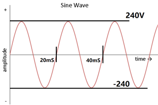

    We are trying to measure 240VAC 50Hz supply and also Current being consumed using a CT.
    240VAC is dropped down and oscillates between 600mV to 1.8V with 50Hz frequency using a resistor bank & a capacitor filter. Each cycle of our 50Hz signal is 20ms. This AC signal is being read by an ADC of nRF52810. But I observed that when voltage is being increased or decreased nordic chip is taking time to reflect those signal changes.
