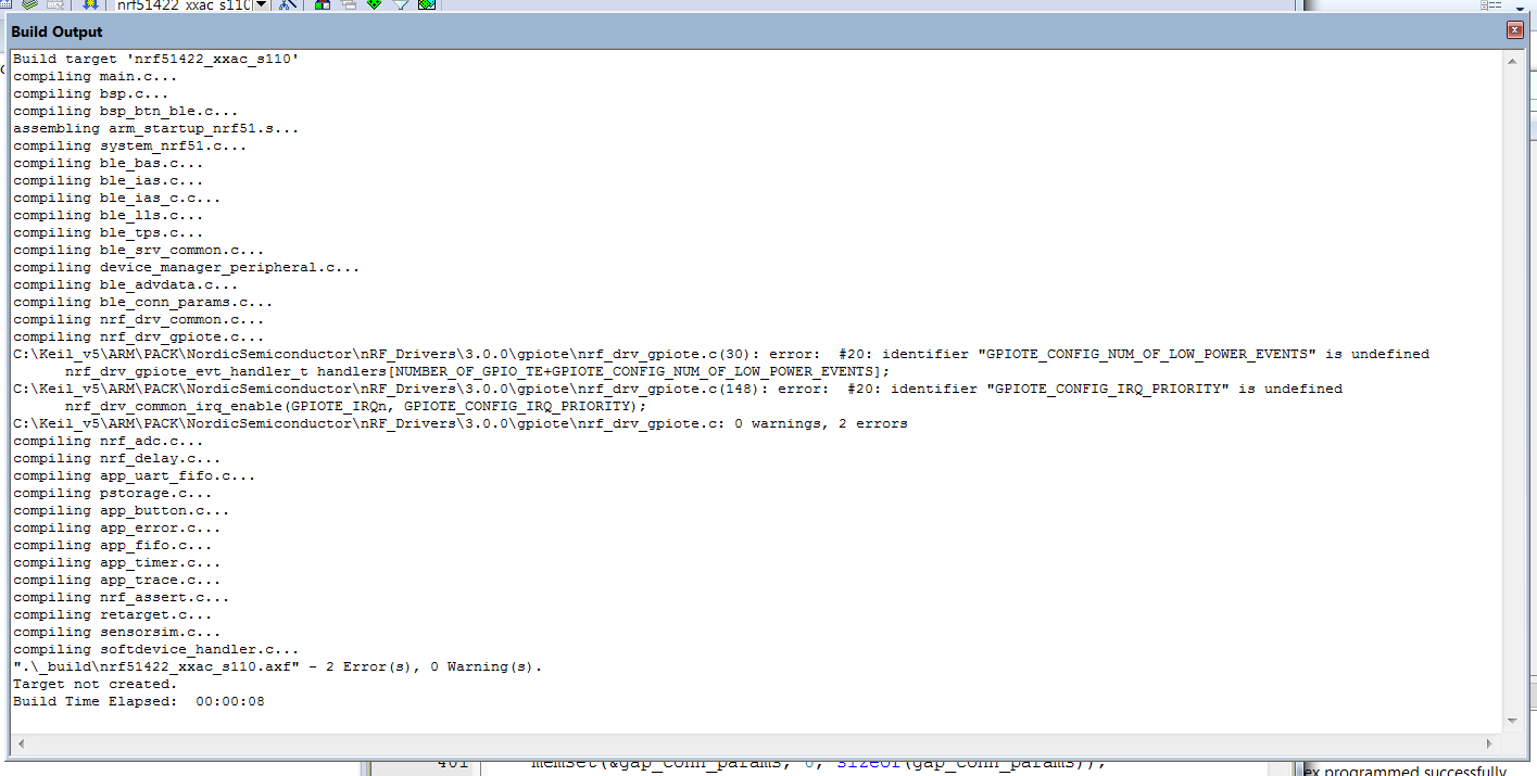

Examples like the "proximity application" are all associated with the nRF51422_xxAC. The part I'm using is the nRF51822_xxAA. How do I make this examples work with my part? I get the build errors shown in the attachment. Capture2.PNG

You seems to have missed to enable GPIOTE_ENABLED flag in components\drivers_nrf\config\nrf_drv_config.h file
#define GPIOTE_ENABLED 1
ok, looked into this. The example is made and tested for nRF51422_xxAC(hence the project is located in pca10028 folder). when changing the device it will take all new config files from all sw components and it will take them from default settings from pack. The example has modified default configuration in headers for (xxAC). So the point is that you have to fix the configuration manually if you change your device name. Just compare the settings in the folders here
C:\Keil_v5\ARM\Pack\NordicSemiconductor\nRF_Examples\8.1.1\ble_peripheral\ble_app_proximity\pca10028\s110\arm5\RTE
