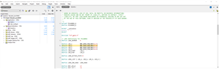

Hi, dear Nordic & all:
  When I run libuarte example,I found a problem, I just set P0.14 to high at the begin of mian function, then I send data and test the example's function by serial port(tx pin is 6, rx pin is 8),  I found P0.14 have been changed to low automatically, I sure I didn't set it to low in other place,it changed to high when I send data once again,;
My environment is follow:
Hardware: nrf52840DK
Example: xxx\nRF5_SDK_17.0.2_d674dde\examples\peripheral\libuarte\main.c
The result is normal:
Code here:

Why the P0.14 is changed to low/high automatically?
