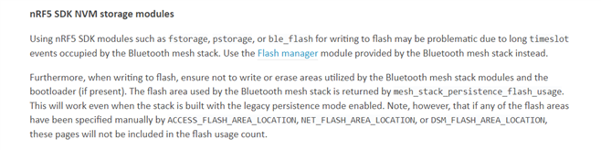

  • Hi Jeffe,
    If you have a look at the mesh_flash module you can find that the flash is accessed directly via NVMC not via softdevice. The flash activity occurs inside mesh timeslot can access flash directly via NVMC.
    A good example of using the flash manager is in the enocean_switch example where we store the enocean information to flash. This documentation is also very useful.
  • Oh, so the flash manager of the mesh SDK doesn't actually use the softdevice by directly uses the NVMC - and by extension any flash storage implementation that directly use the NVMC and skip the softdevice should also work?
    I will take a good look at stuff you recommended, thanks!
  • Hi Jeffe,
    I'm checking with the mesh team on what should be the best way of doing this. But as it's suggested in the documentation here:
    It's preferred to use Flash Manager. Note that the reason it can access flash directly without using softdevice API is because it's running inside Mesh timeslots. If you use your own flash library that access flash via NVMC there is a risk that it operates outside Mesh timeslots. This will cause a fault.
  • I see, so that is why flash manager is the best option. I have went ahead and decided to use that via mesh_config. Thank you for all the help
