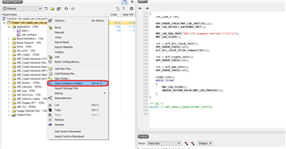

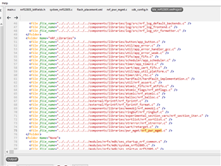

  • To open the *.emProject file, right click on the project folder in the Project explorer view and then select 'Open solution in Editor'. Editing the emProject file directly will however have the same effect as adding the file through the GUI like you did, so I'm afraid this won't help solve the issue.
    Your project built fine here after I added the nrf_pwr_mgmt.c source. Are you still using the same sdk_config.h file that you sent me earlier?
