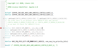

in fact the error that i posted is related to this file and exactly to the bloc in grey on nvic.h file
"  C:/Users/rzaafouri/ncs/v1.5.1/zephyr/include/arch/arm/aarch32/cortex_m/nvic.h:15:44: error: pasting ")" and "_P_arm_num_irq_priority_bits" does not give a valid preprocessing token  "
C:/Users/rzaafouri/ncs/v1.5.1/zephyr/include/arch/arm/aarch32/cortex_m/nvic.h:15:32: error: 'arm_v8m_nvic' undeclared (first use in this function)
 C:/Users/rzaafouri/ncs/v1.5.1/zephyr/include/devicetree.h:463:48: error: expected ')' before '_P_arm_num_irq_priority_bits'
C:/Users/rzaafouri/ncs/v1.5.1/zephyr/include/arch/arm/aarch32/exc.h:24:36: note: to match this '('
1> C:/Users/rzaafouri/ncs/v1.5.1/zephyr/include/arch/arm/aarch32/cortex_m/nvic.h:15:28: error: missing binary operator before token "("
i'm getting these couple of errors do you know if there's a link between them

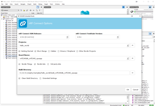

    Could I see your prj.conf file? Is your project based on a sample, or is it something you built from scratch? And which board version are you using? There should be a sticker on your board with "PCA10095 0.11.0" or something similar.
    I also just noticed that you are using two different SDKs. "ncs/v1.5.1/zephyr" and "ncs\v1.5.1-rc1\toolchain" are both used. I assume you are building with Segger Embedded Studio, when you open your project, make sure that both "nRF Connect SDK Release" and "nRF Connect Toolchain Version" are set to the same SDK. It is a known issue that they may be set to different SDKs by default, when you have multiple versions installed.
    thank you Oivind

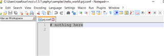

    my prj.conf file looks like this
    and it's a project took from samples
    m using PCA10095 0.11.0
    how do i set  "nRF Connect SDK Release" and "nRF Connect Toolchain Version" to the same SDK please !
  • i don't know
    C:\Users\rzaafouri\ncs\v1.5.1-rc1\toolchain\opt/bin/arm-none-eabi-gcc -DBUILD_VERSION=v2.4.99-ncs2 -DKERNEL -DNRF5340_XXAA_APPLICATION -DUSE_PARTITION_MANAGER=0 -D_FORTIFY_SOURCE=2 -D__PROGRAM_START -D__ZEPHYR__=1 -I../../../kernel/include -I../../../arch/arm/include -I../../../include -Izephyr/include/generated -I../../../soc/arm/nordic_nrf/nrf53 -IC:/Users/rzaafouri/ncs/v1.5.1/nrf/include -IC:/Users/rzaafouri/ncs/v1.5.1/modules/hal/nordic/nrfx -IC:/Users/rzaafouri/ncs/v1.5.1/modules/hal/nordic/nrfx/drivers/include -IC:/Users/rzaafouri/ncs/v1.5.1/modules/hal/nordic/nrfx/mdk -I../../../modules/hal_nordic/nrfx/. -IC:/Users/rzaafouri/ncs/v1.5.1/modules/hal/cmsis/CMSIS/Core/Include -isystem ../../../lib/libc/minimal/include -isystem c:/users/rzaafouri/ncs/v1.5.1/toolchain/opt/bin/../lib/gcc/arm-none-eabi/9.2.1/include -isystem c:/users/rzaafouri/ncs/v1.5.1/toolchain/opt/bin/../lib/gcc/arm-none-eabi/9.2.1/include-fixed -isystem C:/Users/rzaafouri/ncs/v1.5.1/nrfxlib/crypto/nrf_cc312_platform/include -Os -imacros C:/Users/rzaafouri/ncs/v1.5.1/zephyr/samples/hello_world/build_nrf5340dk_nrf5340_cpuapp/zephyr/include/generated/autoconf.h -ffreestanding -fno-common -g -mcpu=cortex-m33 -mthumb -mabi=aapcs -imacros C:/Users/rzaafouri/ncs/v1.5.1/zephyr/include/toolchain/zephyr_stdint.h -Wall -Wformat -Wformat-security -Wno-format-zero-length -Wno-main -Wno-pointer-sign -Wpointer-arith -Wno-address-of-packed-member -Wno-unused-but-set-variable -Werror=implicit-int -fno-asynchronous-unwind-tables -fno-pie -fno-pic -fno-strict-overflow -fno-reorder-functions -fno-defer-pop -fmacro-prefix-map=C:/Users/rzaafouri/ncs/v1.5.1/zephyr/samples/hello_world=CMAKE_SOURCE_DIR -fmacro-prefix-map=C:/Users/rzaafouri/ncs/v1.5.1/zephyr=ZEPHYR_BASE -fmacro-prefix-map=C:/Users/rzaafouri/ncs/v1.5.1=WEST_TOPDIR -ffunction-sections -fdata-sections -std=c99 -nostdinc -MD -MF C:/Users/rzaafouri/ncs/v1.5.1/zephyr/samples/hello_world/build_nrf5340dk_nrf5340_cpuapp/zephyr\CMakeFiles\offsets.dir\arch\arm\core\offsets\offsets.c.obj.d -fno-diagnostics-show-caret -o zephyr/CMakeFiles/offsets.dir/arch/arm/core/offsets/offsets.c.obj -c C:/Users/rzaafouri/ncs/v1.5.1/zephyr/arch/arm/core/offsets/offsets.c
    i don't know why the version v1.5.1-rc1 appears although i'm just using the v1.5.1
    i don't know what can be causing this or how to fix it
  • Ok, open SEGGER Embedded Studio, through the Toolchain Manager's "Open IDE" button, click "File" in the top-left and click "Open nRF Connect SDK Project".
    Then make sure you have the same SDK set for both "nRF Connect SDK Release" and "nRF Connect Toolchain Version", and that you are building for the nrf5340dk and not the nrf5340pdk. Here is a picture to go by:
  • my project was on the good version in both "nRF Connect SDK Release" and "nRF Connect Toolchain Version"
    i re-builded the project and the error remain the same
