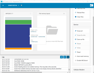

I've recently setup SEGGER embedded studio to program an NRF52832 board and have had issues running the BLE examples.

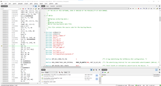

I've been mostly working with the ble_sdk_app_beacon_main code, and all of my attempts to debug it or any other project has led to to the code stopping before it reaches main with a vector catch error.
By reading the memory using the NRF connect programmer I can see that the memory and SoftDevice has seemingly been written correctly. The memory address position matches that in the FLASH_START macro, which suggests the rest of them are correct (but if there is anything there that you think would be worth changing, for instance the RAM_START macro, let me know).
I've been able to flash some pre-programmed hex files and have seen the device acting normally, which suggests this is a software issue. Is there anything in my setup I may have missed or something I need to change?

    The pre compiled hex files that works, are they ble examples?
    Have you modified the example code that you try to flash?
    Willybood said:
    I built this using the settings for the pca10040, although I'm attempting to flash a custom NRF52832 board. Is there something I need to adjust for it, or something I need to ask for from the manufacturer?
     You also need to configure a custom board file for your board.
