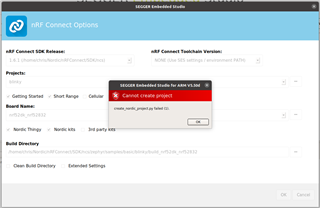

I have tried to open the "Blinky" project for the nrf52dk_nrf52832.  It fails with "create_nordic_project.py failed".
Do you have any suggestions re: where to start to solve the problem?  Is there a log file somewhere that may suggest what the problem is?

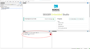

    Please share the full error log. It can be acquired by double pressing the error message in the output window of SES (see the image below).
    Carl Richard
