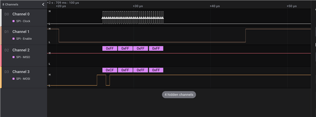

  • Hi Pirun,
    I am working at home today so don't have access to a proper analyser. I do have one of these
    https://hobbycomponents.com/testing/243-hobby-components-usb-8ch-24mhz-8-channel-logic-analyser
    They are cheap and cheerful but do seem to have problems with loading on the line. When I connect the probes with the WINC1500 connected, it seems to struggle to pick up the signals correctly.
    I did however, manage to capture the following with the WINC1500 module removed, so obviously I won't get any data back but can see the clock, chips select and MOSI data.
    Rod
  • HI Rod,
    We can learn SPI master is sending correct signal from your capture while not connecting WINC1500.
    SPIM is trying to reset module.
    #define CMD_RESET				0xcf
    	case CMD_RESET:							/* reset */
    		bc[1] = 0xff;
    		bc[2] = 0xff;
    		bc[3] = 0xff;
    		len = 5;
    However you can't get anything when WINC1500 connected.
    It seems that bus has been pulled down by WINC1500.
    I would suggest that you check the power sequence of WINC1500.
