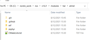

  • Hi Rod,
    The compile error is caused by lacking of HAL of ATMEL WINC1500.
    It doesn't include in nRF Connect SDK.
    Please add ATMEL module in nrf/west.yml.
    Then west update again to pull winc1500 related code.
    Here is sample for you.
    --- a/west.yml
    +++ b/west.yml
    @@ -102,7 +102,12 @@ manifest:
    remote: zephyrproject
    path: modules/lib/openthread
    revision: f460532d4afa5d49feba241e5dc31c56123d31a8
    + - name: hal_atmel
    + remote: zephyrproject
    + path: modules/hal/atmel
    + revision: master
    + groups:
    + - hal
    You can check if there is hal of atmel.

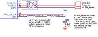

    The second error " <err> net_if: There is no network interface to work with!" is caused by commenting out CONFIG_WIFI=y.
    Once you have HAL of ATMEL, please add back CONFIG_WIFI=y and CONFIG_WIFI_WINC1500=y.
  • Hey Pirun,
    Thanks for your reply. I have updated the west.yml file and ran west update. I can now see the atmel HAL.
    I enable CONFIG_WIFI=y and CONFIG_WIFI_WINC1500=y and rebuild.It now builds without the "wifi errors" I was seeing previously. Although I am seeing an SPI error.
