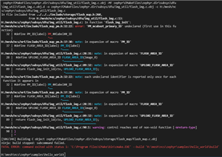

I can't build it without problems.
I notised that  CONFIG_BOOTLOADER_MCUBOOT=y need configed but I don't want to test MCUBoot, so I go to the next step adding MCUboot as an immutable bootloader.

  • If you want to do this, then you can refer to the nRF Desktop projects that use B0 only to see how that is done. You need to adjust your prj.conf as well as your main.c. It is also covered briefly in this tutorial.
    Specifically, for B0 you need the following configuration (adapt key path):
    CONFIG_SECURE_BOOT=y
    CONFIG_BUILD_S1_VARIANT=y
    CONFIG_FW_INFO=y
    CONFIG_FW_INFO_FIRMWARE_VERSION=1
    CONFIG_SB_SIGNING_KEY_FILE="path/to/key.pem"
    However, you would also need to remove the mcumgr related code and add something similar to what is in nrf\applications\nrf_desktop\src\modules\dfu.c (which is added to the nRF Desktop projects by the Kconfig CONFIG_DESKTOP_CONFIG_CHANNEL_DFU_ENABLE configuration to handle the DFU process.
