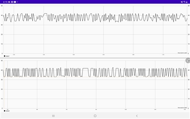

Finally, when I put this code to run with a square wave input to one channel and a sine wave input to another (Both with 600 Hz freq.) I get the following curve:

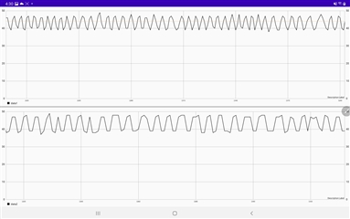

As I increase the frequency (2 kHz), the signal gets distorted:

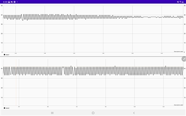

This is the signal seen on the screen of the tablet with an input of 10 kHz:

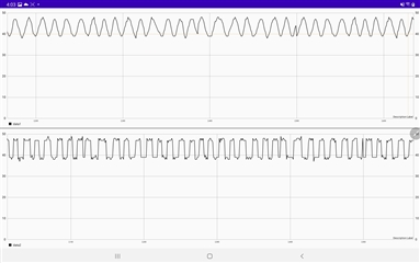

Interestingly, the signal also appears distorted with input at low frequencies. This is what I see when I set the frequency of the input signal at 20 Hz:
What I've been asked to do is: display the signal graph on the tablet screen. If any change happens at the input signal at the ADC, it should be reflected with a delay of less than one second on the tablet screen.
I've been working with this for a long time and the best results I got were what you can see in the 1st two images shown above. I've been listening to things like "I can hear music on my Bluetooth earphones. Why can't you make this work?". But from the little I know, BLE was not really developed for this kind of bulky and continuous data transfer.
So my first question is:
Can it be done using an nrf52840?
The second question comes in case the answer for the 1st is positive:
Is there any problem with how I configured the module? Can I still improve the throughput? Or the configuration is good and I am not correctly handling a Produce/Consumer problem?
I appreciate any help.
Thank you.
    Looking at your samples, if you have 10 ks/s and transfer each sample as an uint_16, that means that the raw dat would be 10 ks/s * 16 bit/s = 160 kbps. You will of course have some overhead, but it should be OK from a throughput perspective. With everything optimal you can get about 700 kbps of throughput with BLE (1 Mbps PHY) and 1400 kbps (2 Mbps phy). (Practical real life throughput will typically be significantly lower though, for several reasons.)
    You use a too short connection interval. To achieve higher throughput it is better to use longer connection intervals, and ensure that the event length is as long as the connection interval. This way you can send many packet per connection interval. With NRF_SDH_BLE_GAP_EVENT_LENGTH set to 400 (*1.25 ms) you can set the connection interval to 0.5 s, which may be a sensible value. Then transfer data using long indications (> 200 byte).
    There is a trade-off with long event lengths and connection intervals, though. Whenever there is a packet loss the retransmission happens in the next connection event. So in this case you will spend a long time before being able to retransmit. And in that case you would have to buffer up the data. This also makes the whole think a bitt less rea-time, and this is a limitation of BLE.
