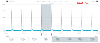

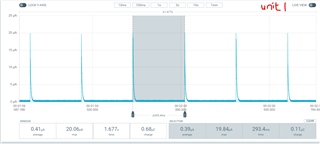

I have 4Pcs same PCBAs and same firmware, the current values as below:
  1. 2.2uA
  2. 3.3uA
  3. 3.0uA
  4. 3.8uA
Condition: Power Supply 3V Battery;  Temperature 22℃; System ON, GPIOTE wakeup;  Measure tool is PPK2.
The maximum is almost double higher than the minimum.
The following are the value after I change the sleep mode to system OFF:
  1. 0.42uA
  2. 0.60uA
  3. 0.60uA
  4. 0.70uA
Condition: Power Supply 3V Battery;  Temperature 29℃; System OFF, GPIO DETECT;  Measure tool is PPK2.
The maximum much higher than the minimum.
Also the time between current spikes vary from device to device.
I swap nRF52840 between unit 1 and unit 4 and find IC is dominate the current consumption.
