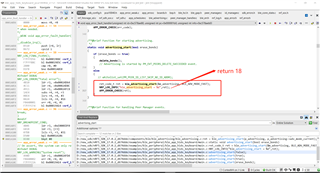

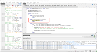

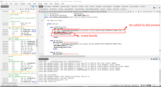

why ble_advertising_start()returns error code 18
Excuse me:
                    Project in nRF5_SDK_17.0.2_d674dde\examples\ble_peripheral\ble_app_hids_keyboard\pca10040e\s112\ses,After the device is connected, I call the sd_ble_gap_disconnect(m_conn_handle, BLE_HCI_REMOTE_USER_TERMINATED_CONNECTION) to disconnect,Then call the  advertising_start(true)  to delete the binding,After the binding is deleted, the advertising_start(false) function is called to start advertise ,then return the error code 18.
