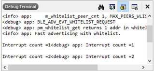

Debugger before the connection, interrupt firing normally

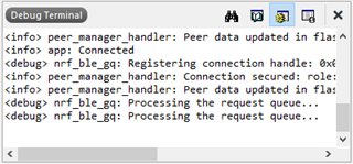

Debugger after the connection, the interrupt never fires in this situation:

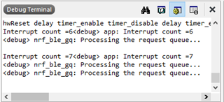

Debugger after the service enable, the interrupt fires again:
