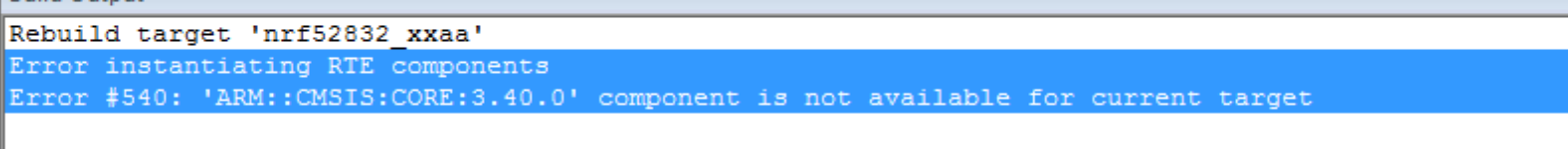

Hello Guys,
can someone help me solve this problem (see picture below). Apparently Keil is missing an RTE and CMSIS component. I don't know where to get them. I installed everything available on the nRF52 Preview DK page.
Thanks in advance.
Regards

Which version of Keil are you using? SDK was tested with Keil 5.14.
I got uVision/MDK V5.1.0
We are testing with Keil 5.14. Unfortunately PACK support in Keil was pretty immature in 5.1.0 so there might be some issues. I would recommend to switch to v5.14.
Well, this is unfortunate. In this case i will switch to Kiel v5.14+
Not much imput from me i guess, but i'm using Keil 5.14 and didn't have any problems with programming the DK
