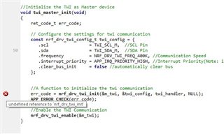

  • Thank you. Now I can communicate with 2 devices via BLE.
    But I am getting errors while combining 2 programs(Twi read program and Ble communication Program)
    I have updated Config.h file and Included other .h and .c files.
    It successfully Builds when there is No function in main.c for TWI communication.
    But if I add any function of TWI to the main.c it shows errors and doesn't build.
    For example when I use the function "twi_master_nit()" which was exactly used in the separate TWI program. it shows the following error.
    Most probably this is due to one or more of the following reasons:
    • The config file hasn't been configured properly. Diff your config file with the TWI example config file, and see what's different.
    • The path to the added source file isn't included in the project settings.
    • The proper header/source files haven't been included.
