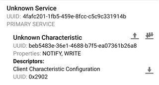

Hello, I have custom BLE service and characteristic as below image.
I wanted to discover them in ble central mode. I have modified ble_hrc_c.c to validate but central not able to discover. Can anyone suggest? Also attaching code.

  • Did you implement the BLE Peripheral as well?
    Do you have a requirement for different base UUIDs in your project?
    What is usually recommended is to use a 128-bit vendor specific UUID which will look something like this "4A98xxxx-1CC4-E7C1-C757-F1267DD021E8" as a “base UUID”. The four x’s represent a field where you will insert your own 16-bit IDs for your custom services and characteristics and use them just like a predefined UUID. You will have different customs UUID for each service and characteristic but only one "base UUID".

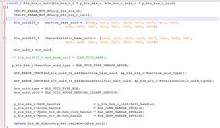

  • it wouldn't discover with the below code
    uint32_t ble_lbs_c_init(ble_lbs_c_t * p_ble_lbs_c, ble_lbs_c_init_t * p_ble_lbs_c_init)
        uint32_t      err_code;
        ble_uuid_t    lbs_uuid;
        ble_uuid128_t   service_base_uuid =  {0x4b, 0x91, 0x31, 0xc3, 0xc9, 0xc5, 0xcc, 0x8f,
                                  0x9e, 0x45, 0xb5, 0x1f, 0x00, 0x00, 0xaf, 0x4f};
        ble_uuid128_t   characteristic_base_uuid =  {0xa8, 0x26, 0x1b, 0x36, 0x07, 0xea, 0xf5, 0xb7,
                                  0x88, 0x46, 0xe1, 0x36, 0x00, 0x00, 0xb5, 0xbe};
        VERIFY_PARAM_NOT_NULL(p_ble_lbs_c);
        VERIFY_PARAM_NOT_NULL(p_ble_lbs_c_init);
        VERIFY_PARAM_NOT_NULL(p_ble_lbs_c_init->evt_handler);
        p_ble_lbs_c->uuid_type = BLE_UUID_TYPE_VENDOR_BEGIN;
        //err_code = sd_ble_uuid_vs_add(&lbs_base_uuid, &p_ble_lbs_c->uuid_type);
        err_code = sd_ble_uuid_vs_add(&service_base_uuid, &p_ble_lbs_c->uuid_type);
        if (err_code != NRF_SUCCESS)
            return err_code;
        VERIFY_SUCCESS(err_code);
        err_code = sd_ble_uuid_vs_add(&characteristic_base_uuid, &p_ble_lbs_c->uuid_type);
            return err_code;
        lbs_uuid.type =  p_ble_lbs_c->uuid_type;
        lbs_uuid.uuid = LBS_UUID_SERVICE;
        p_ble_lbs_c->peer_lbs_db.button_cccd_handle = BLE_GATT_HANDLE_INVALID;
        p_ble_lbs_c->peer_lbs_db.button_handle      = BLE_GATT_HANDLE_INVALID;
        p_ble_lbs_c->peer_lbs_db.led_handle         = BLE_GATT_HANDLE_INVALID;
        p_ble_lbs_c->conn_handle                    = BLE_CONN_HANDLE_INVALID;
        p_ble_lbs_c->evt_handler                    = p_ble_lbs_c_init->evt_handler;
        return ble_db_discovery_evt_register(&lbs_uuid);
    but when I change lbs_uuid.type to 0, I am getting NRF_ERROR_INVALID_PARAM at ble_db_discovery_start().
        uint32_t      err_code;
            return err_code;
            return err_code;
        lbs_uuid.type =  0 ; //p_ble_lbs_c->uuid_type;
  • I have 2 services. One has 3 and another got 1 characteristic. For now I just want to discover only 1 characteristic.
