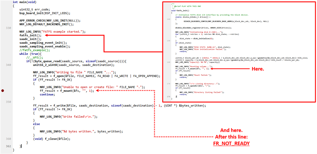

            ff_result = f_open(&file, FILE_NAME2, FA_READ | FA_WRITE | FA_OPEN_APPEND);
            if (ff_result != FR_OK)
                NRF_LOG_INFO("Unable to open or create file: " FILE_NAME ".");
            ff_result = f_write(&file, saadc_destination, sizeof(saadc_destination) - 1, (UINT *) &bytes_written);
                NRF_LOG_INFO("Write failed\r\n.");
            else
                NRF_LOG_INFO("%d bytes written.", bytes_written);
            (void) f_close(&file);

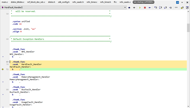

However, the f_open() function always returns FR_NOT_ENABLED
And the device ends up stuck here:
This error seems to happen in this location at the file ff.c:
However, If I call the function fatfs_example() I can save the example file NORDIC.TXT without any errors.
Would anyone happen to know what could be causing the error?

  • Hi
    Typically this happens if you forget to mount the drive before you try to access it.
    Do you make sure to call f_mount(..) anywhere?
    Best regards
    Torbjørn

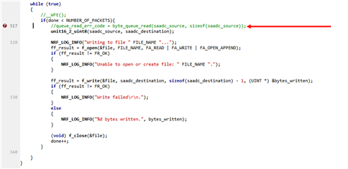

  • I tried copying the ADC data to a global array and converting it to uint8_t (in the ADC callback function). In the while loop, I get the data and save it in the file. It worked this way. Somehow the byte_queue_read function is interfering with the SD card functionality.

  • Hello.
    Sharing the code is not a problem at all. Most of the work was done by Nordic anyway. However, I was preparing to share the code and I seem to have fixed the problem. To be honest, I am not sure how I fixed it, but I suspect it was a problem with the configuration of the queue. I was trying to store the uint16_t data type coming from the ADC in the queue, but then I decided to convert the data before storing it in the queue (Convert from uint16_t to uint8_t). So, I changed the queue configuration to store uint8_t data and it worked!
    Still, I am sharing the code in case someone needs it. This code configures the nrf52840 to sample 120 samples from pins p.0.04 and p.0.05, converts the data from unit16_t to uint8_t (120 samples become 240 elements), and rearranges the samples in an array with 240 samples, being that the first 120 elements correspond to channel 1 and the last 120 elements correspond to channel 2.
