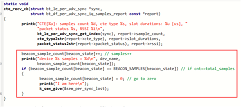

  • Hi Simonr,
    These days I have tried to switch between different beacons to receive multiple beacons' IQ values. What my solution is to create a variable beacon_sample_count to record and count number of CTE with IQ values received. When beacon_sample_count reaches the number of samples to be received, I just add the code k_sem_give(&sem_per_sync_lost); to cte_recv_cb hoping to terminate the sync and go to next scan to receive other beacons' IQ values.
    the code is like this:

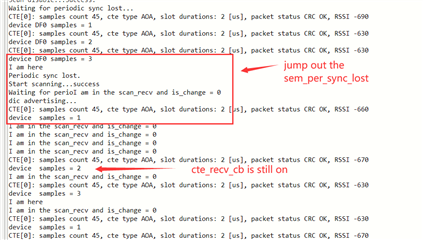

    However, when I run the code in the board and print the log information in the terminal windows. At the first time, it do jump out the code err = k_sem_take(&sem_per_sync_lost, K_FOREVER);  in the main(), but it continues to go into the cte_recv_cb.
    the log information is like this:
    To sum up, I just want to terminate the sync between the locator and beacons in the locator side purposely and receive CTE from another beacons, even the beacon connected is still working. Thanks a lot!
  • Hi
    To be clear, are you trying to disconnect and remove synchronization before the IQ sampling is done? You will need to do a full sampling period before moving to the next beacon. What I would suggest is to reduce the number of samples taken in each sampling period instead of trying to stop it in the middle of sampling.
    Simon
