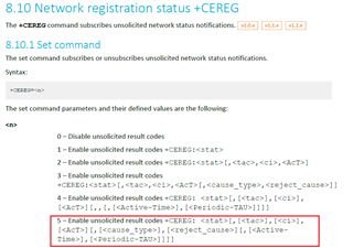

  • Hi Didrik

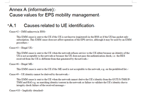

    For CEREG, at mqtt_simple sample, it set "AT+CEREG=5" to modem. So, subscribes CEREG notifications as below format according to at commands spec. Notification shall have cause type and reject cause defined at 3GPP 24.301 Annex A.
    I checked 3GPP 24.301. I did analyze the failure reason in much detail.

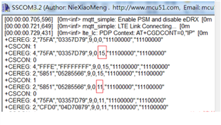

  • Hi Didirk
    Then, I tried DK at a shielding room not ot connect the cell site.
    After connecting timeout, it got CEREG notifications with reject cause 11 and 15.
    11 => PLMN not allowed
    15 => No suitable cells in tracking area
  • How shielded is your shielded room?
    The log shows that it finds a network, and tries to attach to it, but is not allowed for the reasons you described.
    If it didn't find any networks the tac and ci fields should be "FFFE" and "FFFFFFFF", and more importantly the %CESQ notification fields should be 99 for the first two, and 255 for the rest.
