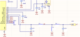

my question concerns the layout of a bluetooth antenna & tuning circuitry for an nRF52832. Specifically, about two separate concerns:
1) Due to the shape of the PCB, the antenna is intended to be placed on an extruding part of the board, sort of like a thin arm. The nRF itself doesn't fit there, so the trace from the nRF to the antenna would probably be slightly longer (up to around 15-20mm). My question is, how long can those traces be until the signal quality starts to noticeably degrade? Or is it just a matter of having to compensate for the longer trace in my tuning circuit?
2) The second question is sort of related to the first: should the tuning circuit be placed as close as possibly to the nRF or the antenna? Can/should I increase the distance between individual components on the way to the antenna, or keep the tuning circuit together as close as possible? See below for a schematic of my tuning circuit.

    the radio matching network should be placed close to the radio and the antenna matching network should be placed close to the antenna:
    The transmission line between the two matching network should be a 50 Ohm coplanar wave guide:
    The length, L, does not matter in theory, but a very long RF path is not optimal, but 15-20 mm is not a problem.
    The reference design, is under downloads on the product page; QFN.
