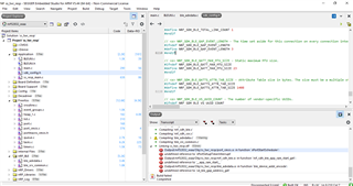

I copied the main file source code from the ble_app_beacon example from nrf SDK to a new file in ss_twr_resp example to integrate BLE with UWB and give a demonstration (I haven't advanced to the scanning yet just trying to get BLE and UWB working together). I added all necessary files through SEGGER using "add existing file". Furthermore, for every file I added, I also went to the options of the project, into preprocessor, and added the folder path to "User included Directories". When I build the project, I get the following:

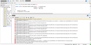

Mainly, I see two errors. Error 1 indicates there are two definitions of specific functions. I'm quite sure I did not define them twice. However, I don't know how to approach this problem.
Error 2 indicates undefined references, which are functions that cannot be found. Although I included the necessary file in SEGGER through "add existing file", and preprocessing, I still get this error (for instance app_timer.h is added, but app_timer_init() still is undefined, according to SEGGER). This is how I solved the same other errors I was getting, but these ones seem to persist.

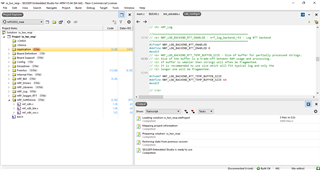

    Great! Could you confirm whether you also enabled the different added modules in the sdk_config.h file?
    For example, when adding the application timer library to your project you will need to add the source file and include path (which you have already done), but you will also need to define APP_TIMER_ENABLED 1 in your sdk_config.h for the app_timer.c code to be compiled and included in your project.
    You will need to do this for all nrfx driver etc. that you will be using as well.
    Please also make sure that there is only a single *_ENABLED defined for each module. I.e do not have both TIMER_ENABLED and NRFX_TIMER_ENABLED defined (comment one of them out or remove it all together, do not just define it to 0) in your sdk_config as this may cause some trouble with which version of the drivers you are using.
    It is hard for me to comment on the multiple definition here without seeing the code, but it looks to be the an issue with a variable or function called 'advertise', which you should take a closer look at.

    Q1: I enabled the APP_TIME_ENABLED. It was already defined as 0. I changed it to 1. The error seems to have disappeared. However, now most of my errors are multiple definitions. What should I do?
    Q2: I'm a little lost about sdk_config.h. I know what it does. However, when I add a file to my project, how can I know what to enable in that file or which functions need to be enabled?
    Q3: I changed my function name to advertise123 to ensure I'm not overlapping with any built-in variable/function name. However, the issue still seems to persist.

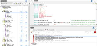

    Thanks a lot for your suggestions. It turns out that I had to remove some files from the Freertos folder in SEGGER to eliminate the multiple function declaration issue. The only issue I'm having is the undefined reference.
    The way I solved this issue is that I'd go to the example in the nRF5_SDK_14.2.0 folder and run the example ble_app_beacon. When a function is undefined in my ss_twr_resp example, I'd add the existing file, and add the file path to the preprocessor. This was enough to get rid of most of the undefined references.
    However, although I added the necessary files to SEGGER and double-checked my preprocessor path list, SEGGER doesn't detect them. The necessary files are there, such as "nrf_sdh_ble.h" for the nrf_sdh_ble_default_cfg_set(APP_BLE_CONN_CFG_TAG, &ram_start) issue, but SEGGER is not detecting it. I Googled the error and found sources, such as https://stackoverflow.com/questions/5559250/c-error-undefined-reference-to-function-but-it-is-defined. I don't think this is a general C issue, but might be a SEGGER one. I'd appreciate any kind of advice, and thanks a lot for your help man, I'd been making progress! Here's also my project in case I missed a detail:
    Could you make sure that the path to these files does not exceed the 260 char limit set by Windows? Please also make sure that you have no trailing white-spaces anywhere in your User Included Directories - this will likely break the paths.
    In general, it is also recommended to make sure that you do not have any white-spaces in the paths provided, but this is more of a general c tip.

  • In the user included directory, I double-checked for trailing spaces and 260 character limits. I copied the user included directory to a text file and used control-F to find any spaces and it seems clear. I especially moved my project to my C: directory to get the shortest path possible. However, I'm still getting the same errors.
  • Great, thank you for letting me know.
    Could you confirm that you are making these changes in the options for the common build configuration? All other build configurations inherits from the common one, so if you make the change here it will apply to all your build configurations.
    If you are already doing this in the common build configuration, could you send me your SES project file so I may take a look, and also let me know what the absolute path to the file is in your system?
