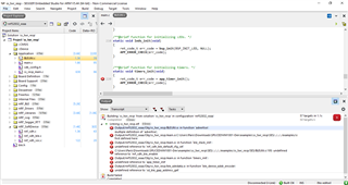

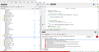

I copied the main file source code from the ble_app_beacon example from nrf SDK to a new file in ss_twr_resp example to integrate BLE with UWB and give a demonstration (I haven't advanced to the scanning yet just trying to get BLE and UWB working together). I added all necessary files through SEGGER using "add existing file". Furthermore, for every file I added, I also went to the options of the project, into preprocessor, and added the folder path to "User included Directories". When I build the project, I get the following:
Mainly, I see two errors. Error 1 indicates there are two definitions of specific functions. I'm quite sure I did not define them twice. However, I don't know how to approach this problem.
Error 2 indicates undefined references, which are functions that cannot be found. Although I included the necessary file in SEGGER through "add existing file", and preprocessing, I still get this error (for instance app_timer.h is added, but app_timer_init() still is undefined, according to SEGGER). This is how I solved the same other errors I was getting, but these ones seem to persist.
