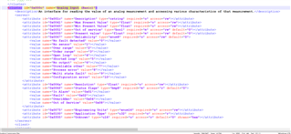

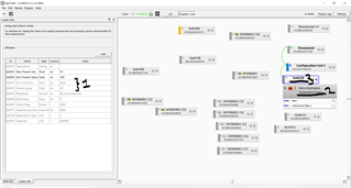

I tried implementing basic cluster, Analog Input cluster and Power Config Cluster. My end application is report "measured tank level" using zigbee. For which nordic engineer suggested me to use Analog Input cluster.
From them I am able to see basic cluster, Analog Input cluster (few attributes from analog cluster are non editable even though access is "RW").
But I am not able to see the power config cluster and its attributes. I feel, I have followed the steps mentioned in nordic info center correctly and I am not able to locate the problem.
I request you to please help me with this. Please find the attached firmware files and the image with the clusters for your reference.
Also it will be helpful with the following problems:
1) Regarding few attributes in analog cluster: I am not able to edit them when using deConz application even though they have read write access. Please find the attached image for your reference. In the image I have marked the problem with "1". Please guide me how can I have "read/write access". I have created the analog input cluster taking the reference of pressure sensor.c and .h file, Binary Input.h and multisensor project. In the attached analog input.h file please ignore the comments as they relate to binary input.
2) How can I change the name from temperature sensor to other custom name? I have marked the problem with " 2 " in the attached image.
3) How can I get the custom name in the place of the NWK ID (for example you can see the name " thermostat" for the thermostat device). I have marked the problem with " 3 " in the attached image.
