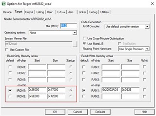

  • o.k.
    As we use Keil IDE, there is a window there, with ROM areas mapping.
    I just excluded the area, I want to erase, from ROM map - and Keil now is not setting NO bits at all in BPROT register.
    My ROM area, I want to erase, is one page long, and starts from 0x6D000 address.
    I can do it myself, instead - I mean - switch on all ROM pages protection, I want.
    I guess, at this point, the ticket can be closed.
    Thanks everybody!

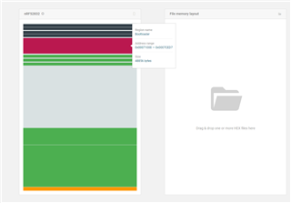

  • 0x71000 and 0x78000 are both common start addresses for the bootloader. Could you please check if you have anything at these addresses? You can use the programmer app in nRF connect for this.
    Memory layout read from nRF52832 with the Programmer app
  • nRF_Connect_Programmer_1629478104493.hex
    Do not know about NRF Connect, but if to load my Application.hex file into J-Flash program - it shows, that only the region 0x26000 to 0x6EFFF is occupied
  • All right. Looks like there was some mess with the Soft Device and the Bootloader from the previous runs of the program on this device.
    1) I got to J-Flash, and program Application_complete.hex file into my NRF52832. Application_complete.hex is a merged file of s132_nrf52_7.0.1_softdevice.hex + Application.hex + Bootloader.hex + settings_application.hex. This file does not work properly.
    2) I go to Keil IDE, load the project. which generates Application.hex, and start it in Debug mode. It sometimes work, sometimes not. Note: I have NOT erased Whole chip after J-Link session. So the chip has s132_nrf52_7.0.1_softdevice.hex, Bootloader.hex and  settings_application.hex inside.
    3) I go to J-Flash again, make Whole Chip Erase, load ONLY s132_nrf52_7.0.1_softdevice.hex. Return to Keil, and everything looks like working fine. No Bootloader there. No settings_application.hex.
    Why? Why if not to erase Whole Chip, and not to re-load s132_nrf52_7.0.1_softdevice.hex - why it goes to Bootloader portion of ROM? Is that normal?
    4) I am not sure, that if my Application works fine without Bootloader - it will work good WITH bootloader. I will check it tomorrow or on Monday. Why Bootloader cares about BPROT register?
    Attached is the file, read from the chip with "fresh" softdevice and containing no Bootloader.nRF_Connect_Programmer_1629479650636(No Bootloader).hex

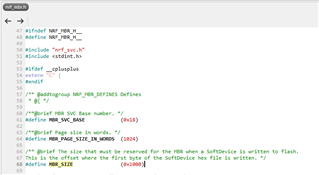

  • Alex@harmoniumLED said:
    It switches on the protection, starting from the address "0" to the address MBR_SIZE, which is the Bootloader area's start address. So - it protects all pages of my program too.
     MBR_SIZE shall always correspond to the size of the MBR. This is not a configurable setting.

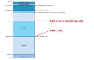

  • ok. Got it.
    How about the following call (from Bootloader project's procedure):
    ret_val = nrf_bootloader_flash_protect(0,
    nrf_dfu_bank0_start_addr() + ALIGN_TO_PAGE(s_dfu_settings.bank_0.image_size));
    It protects the area, starting from the address "0", and ending at the address nrf_dfu_bank0_start_addr() + ...
    if not everything is o.k., it reports:
    if (ret_val != NRF_SUCCESS)
    NRF_LOG_ERROR("Could not protect SoftDevice and application, 0x%x.", ret_val);
    Meaning, that in case of success, it will protect all the memory, from the address 0 to the application's memory end, supposed to be equal to the Bootloader's area start.
    At the end, the Bootloader protects all the memory, except the tail, 1 page.
    I got this Bootloader from the directory:
    ... nRF5_SDK_17.0.0_9d13099\examples\dfu\secure_bootloader\pca10040_s132_ble\arm5_no_packs
    May be "secure_bootloader" means "all memory will be protected"? Or - what?
