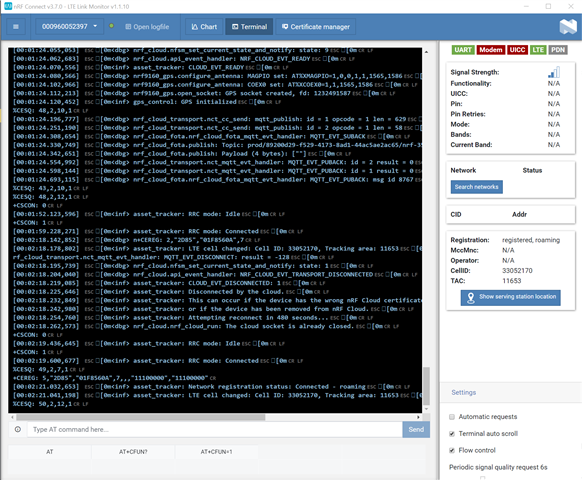

  I am trying to setup test environment using nRF9160DK(PCA10090, 1.0.0)
  Dev kit is located in Montreal, Canada.
  I started with nRF9160_DK_Getting_Started_Guide.
  I flashed latest firmware(nrf9160dk_fw_2021-06-25)
  iBasis SIM is registered. Also, I update certificate manager.
  But, it seems Dev Kit doesn't connect with network.
  I can't proceed further because of this issue.
  On Board side, LED3 is flashing after booting.
  Also, I attached log from LTE Link Monitor and image as below.
  Chongchun Moon

2021-08-17T19:46:07.952Z DEBUG modem << +CEREG: 2,"2D85","01F85600",7
2021-08-17T19:46:07.962Z DEBUG modem << [00:00:22.673,767] [0m<inf> asset_tracker: LTE cell changed: Cell ID: 33052160, Tracking area: 11653[0m
2021-08-17T19:49:32.922Z DEBUG modem >> AT+COPS=?
2021-08-17T19:50:28.912Z DEBUG modem << +COPS: (1,"","","302220",7),(1,"","","302610",7)
2021-08-17T19:50:28.914Z DEBUG modem << OK
2021-08-17T19:50:28.919Z DEBUG modem >> AT+COPS?
2021-08-17T19:50:28.923Z DEBUG modem << +COPS: 0
2021-08-17T19:50:28.925Z DEBUG modem << OK
2021-08-17T19:55:45.631Z DEBUG modem << [00:10:00.368,041] [0m<inf> lte_lc: Network connection attempt timed out[0m
2021-08-17T19:55:45.667Z DEBUG modem << +CEREG: 0
2021-08-17T19:55:45.679Z DEBUG modem << [00:10:00.410,461] [0m<inf> asset_tracker: LTE cell changed: Cell ID: -1, Tracking area: -1[0m
2021-08-17T19:55:45.686Z DEBUG modem << [00:10:00.419,128] [0m<inf> lte_lc: Using fallback network mode[0m
2021-08-17T19:57:35.203Z DEBUG modem << +CEREG: 4

2021-08-17T20:01:54.361Z DEBUG modem << 26 NRF_I2S              Non-SecureOK
2021-08-17T20:01:54.363Z DEBUG modem << 27 NRF_GPIOTE1          Non-SecureOK
2021-08-17T20:01:54.365Z DEBUG modem << SPM: NS image at 0x20200
2021-08-17T20:01:54.373Z DEBUG modem << SPM: NS MSP at 0x200257a8
2021-08-17T20:01:54.374Z DEBUG modem << SPM: NS reset vector at 0x2a0cd
2021-08-17T20:01:54.375Z DEBUG modem << SPM: prepare to jump to Non-Secure image.
2021-08-17T20:01:54.586Z DEBUG modem << *** Booting Zephyr OS build v2.6.0-rc1-ncs1  ***
2021-08-17T20:01:54.592Z DEBUG modem << [00:00:00.206,451] [0m<inf> asset_tracker: Asset tracker started[0m
2021-08-17T20:01:54.605Z DEBUG modem << [00:00:00.212,646] [0m<inf> watchdog: Watchdog timeout installed. Timeout: 60000[0m
2021-08-17T20:01:54.606Z DEBUG modem << [00:00:00.220,245] [0m<inf> watchdog: Watchdog started[0m
2021-08-17T20:01:54.623Z DEBUG modem << [00:00:00.232,482] [0m<dbg> nrf_cloud_transport.allocate_and_copy_client_id: client_id = nrf-351358811387379[0m
2021-08-17T20:01:54.639Z DEBUG modem << [00:00:00.243,164] [0m<dbg> nrf_cloud_transport.nct_topics_populate: accepted_topic: nrf-351358811387379/shadow/get/accepted[0m
2021-08-17T20:01:54.647Z DEBUG modem << [00:00:00.254,577] [0m<dbg> nrf_cloud_transport.nct_topics_populate: rejected_topic: $aws/things/nrf-351358811387379/shadow/get/rejected[0m
2021-08-17T20:01:54.660Z DEBUG modem << [00:00:00.267,089] [0m<dbg> nrf_cloud_transport.nct_topics_populate: update_delta_topic: $aws/things/nrf-351358811387379/shadow/update/delta[0m
2021-08-17T20:01:54.672Z DEBUG modem << [00:00:00.279,998] [0m<dbg> nrf_cloud_transport.nct_topics_populate: update_topic: $aws/things/nrf-351358811387379/shadow/update[0m
2021-08-17T20:01:54.689Z DEBUG modem << [00:00:00.291,839] [0m<dbg> nrf_cloud_transport.nct_topics_populate: shadow_get_topic: $aws/things/nrf-351358811387379/shadow/get[0m
2021-08-17T20:01:54.691Z DEBUG modem << [00:00:00.303,833] [0m<inf> asset_tracker: Connecting to LTE network.[0m
2021-08-17T20:01:54.697Z DEBUG modem << [00:00:00.310,424] [0m<inf> asset_tracker: This may take several minutes.[0m
2021-08-17T20:02:05.221Z DEBUG modem << +CEREG: 2,"2D85","01F85600",7
2021-08-17T20:02:05.230Z DEBUG modem << [00:00:10.841,949] [0m<inf> asset_tracker: LTE cell changed: Cell ID: 33052160, Tracking area: 11653[0m
2021-08-17T20:04:09.054Z DEBUG modem >> AT+COPS=?
2021-08-17T20:05:05.113Z DEBUG modem << +COPS: (1,"","","302220",7),(1,"","","302610",7)
2021-08-17T20:05:05.114Z DEBUG modem << OK
2021-08-17T20:05:05.117Z DEBUG modem >> AT+COPS?
2021-08-17T20:05:05.122Z DEBUG modem << +COPS: 0
2021-08-17T20:05:05.123Z DEBUG modem << OK
2021-08-17T20:11:54.731Z DEBUG modem << [00:10:00.368,041] [0m<inf> lte_lc: Network connection attempt timed out[0m
2021-08-17T20:11:54.766Z DEBUG modem << +CEREG: 0
2021-08-17T20:11:54.775Z DEBUG modem << [00:10:00.410,491] [0m<inf> asset_tracker: LTE cell changed: Cell ID: -1, Tracking area: -1[0m
2021-08-17T20:11:54.786Z DEBUG modem << [00:10:00.419,128] [0m<inf> lte_lc: Using fallback network mode[0m
2021-08-17T20:13:44.196Z DEBUG modem << +CEREG: 4

    2021-08-19T13:43:50.896Z DEBUG modem << +CFUN: 1
    2021-08-19T13:43:50.900Z DEBUG modem << OK
    2021-08-19T13:44:12.796Z DEBUG modem << +CEREG: 2,"2D85","01F8560C",7
    2021-08-19T13:44:12.809Z DEBUG modem << [00:01:12.516,235] [0m<inf> asset_tracker: LTE cell changed: Cell ID: 33052172, Tracking area: 11653[0m
    2021-08-19T13:44:19.392Z DEBUG modem >> AT+CFUN=4
    2021-08-19T13:44:19.431Z DEBUG modem << +CEREG: 0
    2021-08-19T13:44:19.446Z DEBUG modem << [00:01:19.151,245] [0m<inf> asset_tracker: LTE cell changed: Cell ID: -1, Tracking area: -1[0m
    2021-08-19T13:44:19.447Z DEBUG modem << OK
    2021-08-19T13:44:36.577Z DEBUG modem >> AT+CFUN=1
    2021-08-19T13:44:36.621Z DEBUG modem << OK
    2021-08-19T13:44:40.121Z DEBUG modem >> AT%XSIM?
    2021-08-19T13:44:40.128Z DEBUG modem << %XSIM: 1
    2021-08-19T13:44:40.135Z DEBUG modem << OK
    2021-08-19T13:45:05.555Z DEBUG modem << *** Booting Zephyr OS build v2.6.0-rc1-ncs1  ***
    2021-08-19T13:45:05.560Z DEBUG modem << I: Starting bootloader
    2021-08-19T13:45:05.564Z DEBUG modem << I: Primary image: magic=unset, swap_type=0x1, copy_done=0x3, image_ok=0x3
    2021-08-19T13:45:05.571Z DEBUG modem << I: Secondary image: magic=unset, swap_type=0x1, copy_done=0x3, image_ok=0x3
    2021-08-19T13:45:05.576Z DEBUG modem << I: Boot source: none
    2021-08-19T13:45:05.578Z DEBUG modem << I: Swap type: none
    2021-08-19T13:45:05.899Z DEBUG modem << I: Bootloader chainload address offset: 0x10000
    2021-08-19T13:45:05.906Z DEBUG modem << I: Jumping to the first image slot
    2021-08-19T13:45:06.170Z DEBUG modem << *** Booting Zephyr OS build v2.6.0-rc1-ncs1  ***
    2021-08-19T13:45:06.176Z DEBUG modem << Flash regionsDomainPermissions
    2021-08-19T13:45:06.178Z DEBUG modem << 00 03 0x00000 0x20000 Securerwxl
    2021-08-19T13:45:06.181Z DEBUG modem << 04 31 0x20000 0x100000 Non-Securerwxl
    2021-08-19T13:45:06.189Z DEBUG modem << Non-secure callable region 0 placed in flash region 2 with size 32.
    2021-08-19T13:45:06.237Z DEBUG modem << SRAM regionDomainPermissions
    2021-08-19T13:45:06.243Z DEBUG modem << 00 07 0x00000 0x10000 Securerwxl
    2021-08-19T13:45:06.245Z DEBUG modem << 08 31 0x10000 0x40000 Non-Securerwxl
    2021-08-19T13:45:06.253Z DEBUG modem << PeripheralDomainStatus
    2021-08-19T13:45:06.255Z DEBUG modem << 00 NRF_P0               Non-SecureOK
    2021-08-19T13:45:06.256Z DEBUG modem << 01 NRF_CLOCK            Non-SecureOK
    2021-08-19T13:45:06.260Z DEBUG modem << 02 NRF_RTC0             Non-SecureOK
    2021-08-19T13:45:06.263Z DEBUG modem << 03 NRF_RTC1             Non-SecureOK
    2021-08-19T13:45:06.272Z DEBUG modem << 04 NRF_NVMC             Non-SecureOK
    2021-08-19T13:45:06.275Z DEBUG modem << 05 NRF_UARTE1           Non-SecureOK
    2021-08-19T13:45:06.276Z DEBUG modem << 06 NRF_UARTE2           SecureSKIP
    2021-08-19T13:45:06.278Z DEBUG modem << 07 NRF_TWIM2            Non-SecureOK
    2021-08-19T13:45:06.280Z DEBUG modem << 08 NRF_SPIM3            Non-SecureOK
    2021-08-19T13:45:06.282Z DEBUG modem << 09 NRF_TIMER0           Non-SecureOK
    2021-08-19T13:45:06.289Z DEBUG modem << 10 NRF_TIMER1           Non-SecureOK
    2021-08-19T13:45:06.290Z DEBUG modem << 11 NRF_TIMER2           Non-SecureOK
    2021-08-19T13:45:06.292Z DEBUG modem << 12 NRF_SAADC            Non-SecureOK
    2021-08-19T13:45:06.294Z DEBUG modem << 13 NRF_PWM0             Non-SecureOK
    2021-08-19T13:45:06.297Z DEBUG modem << 14 NRF_PWM1             Non-SecureOK
    2021-08-19T13:45:06.305Z DEBUG modem << 15 NRF_PWM2             Non-SecureOK
    2021-08-19T13:45:06.307Z DEBUG modem << 16 NRF_PWM3             Non-SecureOK
    2021-08-19T13:45:06.309Z DEBUG modem << 17 NRF_WDT              Non-SecureOK
    2021-08-19T13:45:06.311Z DEBUG modem << 18 NRF_IPC              Non-SecureOK
    2021-08-19T13:45:06.314Z DEBUG modem << 19 NRF_VMC              Non-SecureOK
    2021-08-19T13:45:06.322Z DEBUG modem << 20 NRF_FPU              Non-SecureOK
    2021-08-19T13:45:06.323Z DEBUG modem << 21 NRF_EGU1             Non-SecureOK
    2021-08-19T13:45:06.325Z DEBUG modem << 22 NRF_EGU2             Non-SecureOK
    2021-08-19T13:45:06.328Z DEBUG modem << 23 NRF_DPPIC            Non-SecureOK
    2021-08-19T13:45:06.331Z DEBUG modem << 24 NRF_REGULATORS       Non-SecureOK
    2021-08-19T13:45:06.339Z DEBUG modem << 25 NRF_PDM              Non-SecureOK
    2021-08-19T13:45:06.340Z DEBUG modem << 26 NRF_I2S              Non-SecureOK
    2021-08-19T13:45:06.342Z DEBUG modem << 27 NRF_GPIOTE1          Non-SecureOK
    2021-08-19T13:45:06.344Z DEBUG modem << SPM: NS image at 0x20200
    2021-08-19T13:45:06.346Z DEBUG modem << SPM: NS MSP at 0x200257a8
    2021-08-19T13:45:06.355Z DEBUG modem << SPM: NS reset vector at 0x2a0cd
    2021-08-19T13:45:06.356Z DEBUG modem << SPM: prepare to jump to Non-Secure image.
    2021-08-19T13:45:06.563Z DEBUG modem << *** Booting Zephyr OS build v2.6.0-rc1-ncs1  ***
    2021-08-19T13:45:06.571Z DEBUG modem << [00:00:00.206,451] [0m<inf> asset_tracker: Asset tracker started[0m
    2021-08-19T13:45:06.577Z DEBUG modem << [00:00:00.212,615] [0m<inf> watchdog: Watchdog timeout installed. Timeout: 60000[0m
    2021-08-19T13:45:06.589Z DEBUG modem << [00:00:00.220,214] [0m<inf> watchdog: Watchdog started[0m
    2021-08-19T13:45:06.605Z DEBUG modem << [00:00:00.232,452] [0m<dbg> nrf_cloud_transport.allocate_and_copy_client_id: client_id = nrf-351358811387379[0m
    2021-08-19T13:45:06.612Z DEBUG modem << [00:00:00.243,103] [0m<dbg> nrf_cloud_transport.nct_topics_populate: accepted_topic: nrf-351358811387379/shadow/get/accepted[0m
    2021-08-19T13:45:06.625Z DEBUG modem << [00:00:00.254,516] [0m<dbg> nrf_cloud_transport.nct_topics_populate: rejected_topic: $aws/things/nrf-351358811387379/shadow/get/rejected[0m
    2021-08-19T13:45:06.639Z DEBUG modem << [00:00:00.267,028] [0m<dbg> nrf_cloud_transport.nct_topics_populate: update_delta_topic: $aws/things/nrf-351358811387379/shadow/update/delta[0m
    2021-08-19T13:45:06.656Z DEBUG modem << [00:00:00.279,907] [0m<dbg> nrf_cloud_transport.nct_topics_populate: update_topic: $aws/things/nrf-351358811387379/shadow/update[0m
    2021-08-19T13:45:06.662Z DEBUG modem << [00:00:00.291,748] [0m<dbg> nrf_cloud_transport.nct_topics_populate: shadow_get_topic: $aws/things/nrf-351358811387379/shadow/get[0m
    2021-08-19T13:45:06.673Z DEBUG modem << [00:00:00.303,741] [0m<inf> asset_tracker: Connecting to LTE network.[0m
    2021-08-19T13:45:06.676Z DEBUG modem << [00:00:00.310,333] [0m<inf> asset_tracker: This may take several minutes.[0m
    2021-08-19T13:46:30.869Z DEBUG modem << +CEREG: 2,"2D85","01F8560C",7
    2021-08-19T13:46:30.879Z DEBUG modem << [00:01:24.514,770] [0m<inf> asset_tracker: LTE cell changed: Cell ID: 33052172, Tracking area: 11653[0m
    2021-08-19T13:55:06.710Z DEBUG modem << [00:10:00.368,011] [0m<inf> lte_lc: Network connection attempt timed out[0m
    2021-08-19T13:55:06.748Z DEBUG modem << +CEREG: 0
    2021-08-19T13:55:06.755Z DEBUG modem << [00:10:00.410,400] [0m<inf> asset_tracker: LTE cell changed: Cell ID: -1, Tracking area: -1[0m
    2021-08-19T13:55:06.761Z DEBUG modem << [00:10:00.419,067] [0m<inf> lte_lc: Using fallback network mode[0m
    2021-08-19T13:55:15.295Z DEBUG modem >> AT+CFUN?
    2021-08-19T13:55:15.304Z DEBUG modem << +CFUN: 1
    2021-08-19T13:55:15.309Z DEBUG modem << OK
    2021-08-19T13:56:56.287Z DEBUG modem << +CEREG: 4
