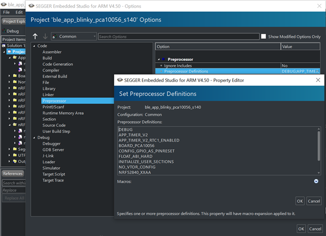

    Could you make sure to have DEBUG defined in your preprocessor defines, like shown in the included image?
    This will make a detailed error message be outputted to your logger whenever a non-NRF_SUCCESS error code is passed to an APP_ERROR_CHECK. Please do this, and let me know what this error message says when the device resets.

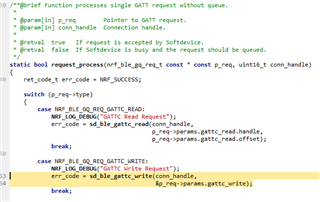

    <error> nrf_ble_gq: SD GATT procedure (1) failed on connection handle 0 with error: 0x00000013.
    <error> app: ERROR 19 [NRF_ERROR_RESOURCES] at C:\Projekte\MyCompany\0288_TT_BLE_Modul\nRF5_SDK_17.0.2_d674dde\examples\ble_central\ble_app_uart_c\main.c:123

  • Hi Karl,
    we tried something to find out the interacting of
    • heartbeat cycle
    • disconnection time and
    • queue size.
    We found the place where the dosconnection time can be set. If we reduce this time (from 4000ms to 1000ms), a disconnection will be recognized before the queue overflows.
    Unfortunately we have not found the place where to adjust the size of the queue. Can this also be found in the sdk_config?

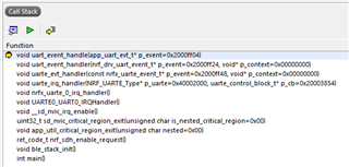

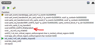

  • Hello again,
    the other issue with the APP_UART_COMMUNICATION_ERROR while initialization seems also to be fixed (by a workaround): We have changed the order of the initialization sequence and have moved uart_init() behind the ble_stack_init().
    While doing so, we have no APP_UART_COMMUNICATION_ERROR  anymore.
    While initialization the uart interrupts are already enabled, although the BLE stack has not yet been initialized. This obviously leads to this error.
    What better solution here than just changing the initialization order?
