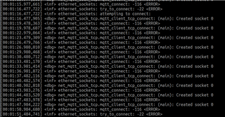

I am currently setting up an MQTT client via the  MQTT publisher sample on zephyr.
My mqtt client is a NRF5340 and it is connected via ethernet with my pc and also mqtt broker on my pc.
The problem I have is as the diagram indicated below

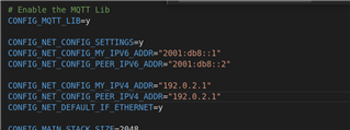

This is some section of my proj.conf

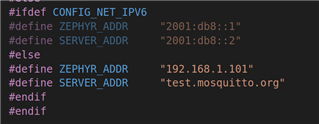

this is some part of my config.h

    I would think the problem is on the PC side, and that the nRF5340 don't have any internet access. The error code is:
    #define ETIMEDOUT 116 /**< Connection timed out */
    The try to connect have error code:
    #define EINVAL 22 /**< Invalid argument */
    So I guess it could also be that the problem is on the nRF5340 if there is an invalid argument.
    Can you tell me a bit more of your setup? Are you using a shield of some sort? Do you have any other examples you can try to check if the ethernet works as expected (e.g. ping)?

    Yes, the problem is with the DHCP server on my pc not automatically providing an IP address. I am not sure what I really did that makes it work as I did a bunch of random stuff. But I believe the problem is because of window firewall.
