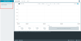

                    PPK2 doesn‘t work,I don't know why,The computer does not recognize the usb port after connecting the USB cable,The indicator light of ppk2 is not on.What should I do?
    Please try the following:
    Disconnect all other nordic devices from the computer, turn off the kit and remove it from the plastic by removing the four screws. Insert USB to J2 (USB DATA/POWER). Short a connection between GND (e.g on the four pin power output header) to TP34 on the PPK2. While holding the jumper cable, turn the kit on and remove the jumper. Now the PPK2 should be in bootloader again.
    Open the PPK app, and select the device which is now just a serial number.
    When selecting it, the user will be prompted to program the application and it should now be working again.
