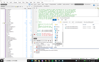

nfc_ble_oob_advdata_parser.h: No such file or directory
Im 100% sure i import the file due to my config

anyone know why this happened??
    Could you elaborate where you have made this configuration, and for which build configuration you have made it?
    Can you also show me the entire path leading to ble_oob_advdata_parser? Windows unfortunately has a path length limit of 260 characters and if a path exceeds this it is never found. Please make sure that the entire path to the file is less than 260 characters - if it is not, you need to place your SDK files higher up in the windows hierarchy, so that the path is shortened.
