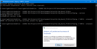

    Why I don't use nrfjprog ? At production plant they prefer to work with Windows PC.
    Using nrfjprog on Linux works fine (verified with ver 10.12.1).
    Using nrfjprog on Windows 10 leads to crashes (verified with ver 10.13.0).
  • I see. nrfjprog works on windows as well, but it seems there may be an issue there that requires investigation. (There are also other Windows tools that would do this, for instance SEGGER J-Flash).
  • I've found out the problem.
    I mistakenly installed the Command Line Tools Win32 version instead of Win64. Now I could rely the verify command of nrfjprog.
