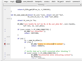

I made a custom model under ncs1.6.0 to publish uart data. When the data I want to publish exceeds 85 bytes, an error occurs in debug:
<err> bt_conn: Unable to allocate TX context

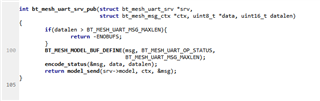

model publish function, at this time datalen is 87:
The specific error is that the tx of the bt_conn_send_cb function in connc.c is NULL.
But in mesh, the maximum data length allowed to be sent is 380 bytes. I don’t know if it is caused by insufficient memory. Can you help me analyze the reason why tx is NULL?
