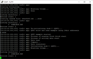

  • Sorry for the delay, I needed to work on something else last week.
    I got this part working. I checked how the block_dev_ram implementation specified an address range, and followed that. So instead of altering the shared geometry struct, I added the offset and size to the block_dev_qspi's config-structure.
    This seems to be working. I still need to integrate the raw block access routines and verify that I can alternate between the two.
  • Ok, I can now alternate between file access and raw block access. I combined the write-read test routine from the qspi example and the fatfs file access tests from usbd_msc.
    Now I need to add these to my actual application. And implement a file transfer method over BLE.
