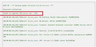

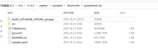

i have nRF Connect SDK v1.6.1,excuted “west update” and “west zephyr-export” command(the project will not built successfully without executing these 2 commands)
then i was trying to run peripheral iso server in nRF5340-DK,but bt_iso_server_register returns ENOTSUP
    This sample uses isochronous channels. Unfortunately, we have not yet released an SDK supporting Bluetooth 5.2 and Isochronous Channels. This is in development. For information on when this can be expected, please contact the Regional Sales Manager in your area, as we don't have any detailed information on release dates, etc. here on DevZone. If you need help contacting them, let me know and I'll get them to reach out to you.
