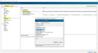

    Q2)
    You are using pin.21? If you have CONFIG_GPIO_AS_PINRESET , then you cannot use this as a normal GPIO pin.
  • Hi Sigurd, Thanks for your help!
    1) Yes, I have disabled the reset pin. I mean, I deleted the following word.
    Deleted the following codes from system_nrf52805.c
        /* Configure GPIO pads as pPin Reset pin if Pin Reset capabilities desired. If CONFIG_GPIO_AS_PINRESET is not
          defined, pin reset will not be available. One GPIO (see Product Specification to see which one) will then be
          reserved for PinReset and not available as normal GPIO. */
        #if defined (CONFIG_GPIO_AS_PINRESET)
            #define RESET_PIN 21
            if (((NRF_UICR->PSELRESET[0] & UICR_PSELRESET_CONNECT_Msk) != (UICR_PSELRESET_CONNECT_Connected << UICR_PSELRESET_CONNECT_Pos)) ||
                ((NRF_UICR->PSELRESET[1] & UICR_PSELRESET_CONNECT_Msk) != (UICR_PSELRESET_CONNECT_Connected << UICR_PSELRESET_CONNECT_Pos))){
                NRF_NVMC->CONFIG = NVMC_CONFIG_WEN_Wen << NVMC_CONFIG_WEN_Pos;
                while (NRF_NVMC->READY == NVMC_READY_READY_Busy){}
                NRF_UICR->PSELRESET[0] = RESET_PIN;
                NRF_UICR->PSELRESET[1] = RESET_PIN;
                NRF_NVMC->CONFIG = NVMC_CONFIG_WEN_Ren << NVMC_CONFIG_WEN_Pos;
                NVIC_SystemReset();
    2) According to your info, I have used UART_PIN_DISCONNECTED for UART rts and cts unused pins. However, the button pin still doesn't work.
    What I found is:
    When I connect the button to pin 21: pin 21 is pulled up and
    - When BLE is advertising (not connected), System ON/OFF button works well.
    - When BLE is connected, System ON/OFF button doesn't work. When I press the button, nothing happens.
    Any idea, please? Thanks in advance!
