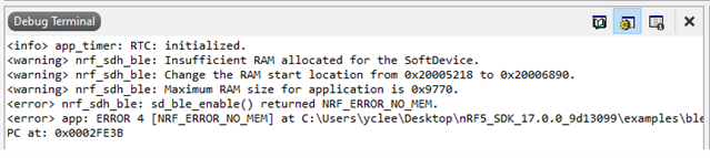

And the error message is occurred when start debugging

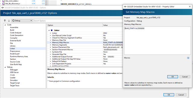

So I try changing the RAM_START address like below,
However, the same message is occurred. I think the setting is not works.
What should I change? And my config setting is right?
