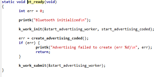

My project consists on a nrf5340dk working as a peripheal UART, i set the advertisment to coded phy like this:

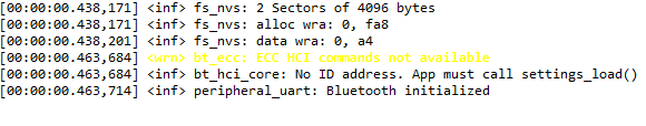

Setting the child image as hr_coded for be available to work on coded. This is my output, so i think that is working but i am not sure:

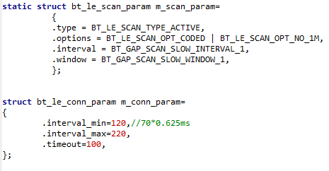

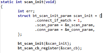

I need to make the scan only on coded_phy, for that i set up the next:
But unfortunately both devices don´t connect, and when i debug central it seem is crashing:
I think maybe i missed something on Kconfig of board... but i don´t know.
My way to implement is correct? There are a better and cleaner way to do it? My parameters of setup for scan and conn have sense?

    Indeed, it seems like your peripheral is running as expected. The "No ID Address" error is not due to the application, but rather the Toolchain Manager, the assert you see further down is related to the Bluetooth controller somehow, so you're probably right in that it is something in your central's parameters or configs that's causing these asserts. I'm not able to reproduce this error on my end with the central_hr_coded example in NCS v1.6.0 (Toolchain Manager v0.9.4 and nRFConnect v3.7.0). By default, the central_hr_coded sample project enable scan filters and extended adv/scanning, and does not run into any errors. What exactly have you changed from the sample project to the project you have now?

    EDIT: For reference, to get rid of the "No ID address" message you're seeing you need to uninstall NCS, the toolchain manager and nRFConnect for Desktop entirely before reinstalling it all. This is due to some issue that we're working on fixing with the Toolchain Manager where it doesn't delete all the settings pages correctly when installing a new NCS version. Applications should run fine anyways though.
  • Finally i succed connecting both devices, changing the filter of conexion of UUID to Name of device. Thanks for the help, i can jump into the next steep trying multilink, i will post new doubts on new threads
