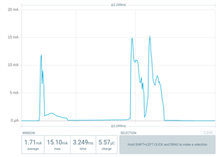

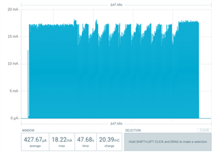

The ppk2 trace clearly shows sequence of three states and the ppk2 reports average current over these events as follows:
1) advertising (push button 1) -- mean current ~950uA, idle current 1.7uA
2) connected (connect via nrfConnect) -- mean current ~277 uA, idle current ~1.2uA
3) notification (toggle notification via nrfConnect) -- mean current ~485uA, idle current ~1.2uA

For the advertising (connectable) role and advertisement interval 20ms, the power profiler gives 591uA mean and 3.1uA idle. The observed values are 950uA and 1.7uA.

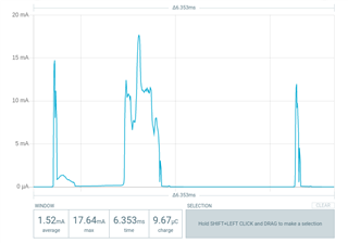

For peripheral (connection) role, connection interval 20ms and payload 20B, the power profiler gives 420uA mean and 3.1uA idle.  The observed values are 485uA and 1.2uA.  The log at the central show that notifications are received correctly, at intervals between 18 and 25ms (there is some ongoing BLE and other interference, but not unreasonable amounts).

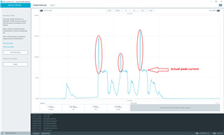

Overall, the peak currents seem to be noticeably higher than those predicted by the profiler (~17mA vs 12mA).  There also seems to be some additional radio activity(?), see detailed traces below.

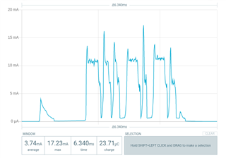

Below are the detailed traces from each measurements.  They are similar to those proposed by the profiler (I don't see an easy way to cut/paste from there), but the peak currents are significantly higher and the notification appears to include an ack (?) that does not appear in the profiler?
Advertising (measured average 950uA vs 591uA for 20ms interval)
Connected (measured average 277uA, 20ms connection interval)
Notification 20ms connection interval, 20B TX payload (measured average 485uA vs 420uA profiled).  Note the ACK (?) that follows the transmission is not seen in the profiler outpur.  (It's also strange, since notification shouldn't have an application layer ack -- it's not an indication.)

    The peak currents are nothing to worry about, as there is (unfortunately) some noise from the PPK2, where it is prone to showing some very high peak currents that are a side effect of the automatic measurement resistor switching (to a higher ampere range).
    These current peaks are negligible in terms of measuring avg. current consumption, but the peak currents will be off. If you're aware of this, you can still use the PPK to measure peak currents, but you need to know what you're looking for. Below is a plot where I've zoomed in on a typical BLE advertising event. The peaks here are product of this bad filtering, and so the actual peak current (or TX current) will be the "peaks" that the arrow points to.

    Okay, first off, the scan request/response is not added in OPP, and will only be included now and then when the scanner asks for it. If you look at another advertising event for instance, you'll see advertising events more similar to the OPP graph.
    Please note that the average current will increase somewhat if you have a scanner that is constantly scanning and asks for scan requests very often.
    As fir tge 591uA over 20ms intervals you see in the OPP, that is without a payload, while in reality an advertisement will always have a payload. If you set the payload to ~20 bytes I think you should get closer to the default power profiling application.
    Also, in the last graph you uploaded, the last spike is not part of the radio event. Try marking the radio event (the two first bulks of current consumptions) and see if the "charge" looks correct compared to charge in the OPP. If it does, the part of the application using BLE/the radio will give the same average as in the OPP.
