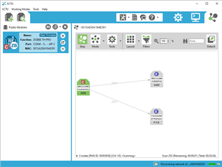

However, we have been using the xbee modules to join our coordinator modules (also xbee S2C) with a predifned TC link key per installation (KY AT command in the xbee). We would like to be able to set this link key in ZBOSS, but I cant find how that is suppose to be done. There seems to be no function for it, only to set the encryption key of the trust centre (which is not the link key).
I tried to change the define in zb_config_common.h:
//#define ZB_STANDARD_TC_KEY {0x5A, 0x69, 0x67, 0x42, 0x65, 0x65, 0x41, 0x6C, 0x6C, 0x69, 0x61, 0x6E, 0x63, 0x65, 0x30, 0x39 };
#define ZB_STANDARD_TC_KEY { 0x39,0x39,0x39,0x39,0x39,0x39,0x39,0x39, 0, 0, 0, 0, 0, 0, 0, 0 }; // TEST KC link key

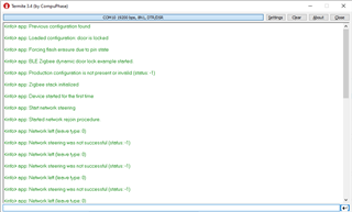

But that didnt seem to do anything. Our product joins just fine on this started network, using this link key:
But the output of the NRF just says it cant do network steering:

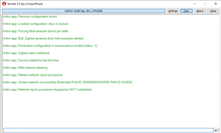

When I restart the network using the default key 5A6967426565416C6C69616E63653039, it works just fine with the NRF:
    I don't have experience with Xbee modules but  from the Zigbee specification: "The default value for the centralized security global trust center link key shall have a value of 5A 69 67 42 9923 65 65 41 6C 6C 69 61 6E 63 65 30 39 (ZigBeeAlliance09)."
    The define ZB_STANDARD_TC_KEY in zb_config_common.h is a pre-compiled parameter and is set to this value based on the Zigbee specification, it's not possible to change.
