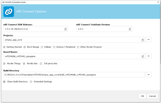

radio_test sample can not work on my nrf5340DK
NCS version:v1.5.1
board:nRF5340DK(0.11.0)

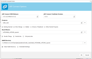

first,i use SES Embedded open radio_test project and choose nrf5340dk_nrf5340_cpunet ,and use [west flash --erase] download net core code after build in SES.
second,i use SES open empty_app_core project and choose nrf5340dk_nrf5340_cpuappns,and use [west flash] download app core code after build in SES.
