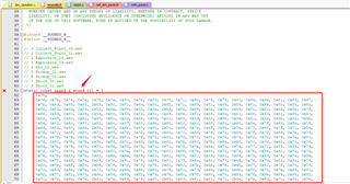

hi,
I see the sample code sound_1 to sound_8, I want to add sound_9, If I have a wav or MP3 file or other audio data, how to make this array ? which tool can produce the data ? I try the winhex tool to get the data array, but don't play the right voice
hi,
winhex + windows record tool , I produce 8bit 8khz sound stream, have sucessfully play, But the sound quality is really poor, is it possible to play better sound quality?
for example:
(1) sample, 44khz or 11khz
(2) 16 bit
Hi
The speaker on the Nordic Thingy:52 is a 15x11mm Rectangle mini speaker (Part No.: BMS1511F-11C-08H03P LF) from BeStar Technologies. Here is the link to the product page, and attached you can find the datasheet.
I think you should be able to play higher quality sounds, but not stream higher quality than 8-bit 8Hz. We have a python script for converting .wav files into output for .c/.h here. Please note that you need a mono .wav file with 16kHz sample. https://github.com/NordicPlayground/nRF52-teensy-sgtl5000-audio/blob/master/Convert%20Audio%20Sample/How%20To.txt
