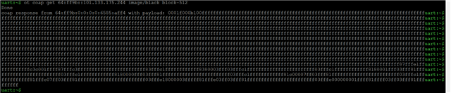

I am trying to use nRF52840dk and the download_client library to download files from my CoAP server.
I am using the CoAP Server example, and I have added the following options in the prj.conf:
# Enable OpenThread SLAAC
CONFIG_OPENTHREAD_SLAAC=y
CONFIG_NET_IF_UNICAST_IPV6_ADDR_COUNT=6
# Enable Download Client
CONFIG_DOWNLOAD_CLIENT=y
CONFIG_DOWNLOAD_CLIENT_COAP_BLOCK_SIZE_512=y
CONFIG_DOWNLOAD_CLIENT_IPV6=y
CONFIG_DOWNLOAD_CLIENT_SHELL=y
Then I built the project and flashed it on the DK. However,  I got errors reported when I run the following commands.

It works fine When I use the OpenThread Shell CoAP command.
Could you please help me with the above erros? Thank you!
