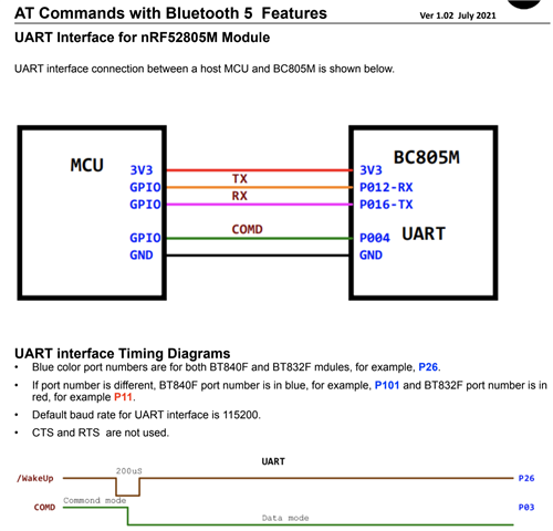

I want to send a simple AT-Command like: AT\r\n from the ESP32 to the Fanstel BC805M (nRF52805M) breakout board.
Problem: The Esp32 does not get a response from the BC805M.

- The ESP32 connects the BC805M by four cables -> 3V3->VDD, GND->GND, Rx->Tx, Tx->Rx. Rx and Tx from ESP32 are Serial2 (not the Serial of the programmer).

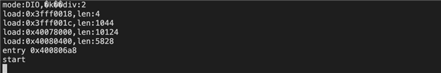

   Serial.println("start");

- While monitoring this, the ESP32 receives no answer from BC805M. By this point I would expect to receive an "OK".

  • When I connect the two ESP32 Rx and Tx Serial2 Pins with each other the monitor prints AT AT AT ...  (so this works)
  • When i connect the ESP32 with the BC805M not by crossing Tx and Rx but like: Rx->Rx, Tx->Tx; I receive the message BlueNor 200622 started! after I pressed the reset button on the BC805M
  • The BC805M has a hardware-switch which I can change by hand and which is connected to P004. I am not completely sure about this, but I think this switch changes between "data mode" and "AT-command-mode":
    I am not sure if I have to connect the 3V3 also to the P004 to activate "AT-Mode". I already tried this and different switch positions, but nothing worked.
  • The docs say: "The default baud rate is 115200, one stop bit and no parity". I guess I always respected that.
  • connecting solely the BC805M per usb to my mac and running arduino IDE's monitor, the monitor prints absolutely nothing and writing AT-Commands also results in nothing. Weird.
  • Could it be possible, that the BC805M is running the wrong firmware?
