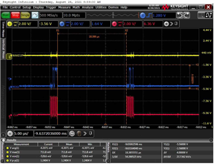

I wish to send SPI message by 2 Bytes per once, total 102 bytes.
Basically SPI works fine.
I wonder if there is way to reduce inter SPI time. It measured 18u sec.
Could it be around 2 u sec?
