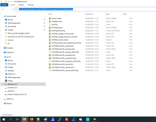

I made a project around the peripherial-uart sample with a custom board for a nrf5340 chip.
I work with win10, Toolchain  nrf Connect SDK 1.6.1
I can build it and make it working well with west.
Now I'll like to use Segger Embedded Studio.

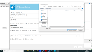

When I open the tab "Open nrf connect SDK project..." and I make the "nrf Connect Option",
I can choose my folder project, but when I browse the Board Name to select my custom board,
it automaticly choose the CPUNET, but I need to use the CPUAPP or CPUAPPNS.
How can I choose the CPUAPP or CPUAPPNS ?
