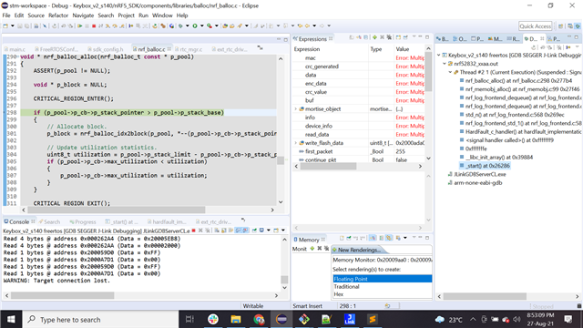

crashing from _start without even entering into main() function
I am using nrf52832 custom board and sdk17.2.0.
My application is a Freertos application. I see that my application is going to hardfault from _start without entering into the main() function.
Attached sdk_config.h , FreeRTOSConfig.h and the screenshot of the hardfault for reference.
Can someone please help me to resolve the issue?
 8358.FreeRTOSConfig.h6215.sdk_config.h
  • Seems like it is happening inside the NRF_LOGs.
    1. If the function call stack can be trusted, then try to disable the logs to see if the issue goes away.
      1. If it does, then the log buffer might not be enough and we can focus more on looking a bit deeper into this NRF_LOG configuration issue.
      2. If it does not help, then most likely the stack is corrupt and I wont be trusting this function call stack much.

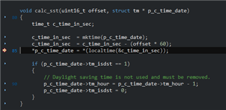

  • i think i found the issue.
    On calling the below rtc function, that issue is coming.
    The issue is coming from return (mktime(&t1));. If i comment this then i dont see the issue.
    But that is needed. Can you please help?

    And same issue is coming even on calling the below set current time function, with ctime and localtime. With this what i observe is there is some issue using the time.h functions. Do i have to enable any macros or add any paths to the project?
