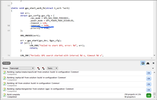

In the AGPS sample for nRF9160 "v1.5.1\nrf\samples\nrf9160\agps" main.c, there is option to set interval an and timeout in "gps_config" structure in "gps_start_work_fn" routine. What is the maximum value of interval that can be set? I am getting error of any interval value greater than 1800 seconds.
Error on the log:
I: CLOUD_EVT_READY
I: Service info sent to cloud
D: GPS mode is enabled
E: Failed to set fix interval value
E: Failed to start GPS, error: -5
I need to set interval value to 4 hours (14400 sec) and 24 hours (86400 sec) for a test that I am doing. Can you suggest where is the limit set and how I can increase it?
  • Hello Pritesh,
    The documentation does not mention any upper limit more than the maximum value of uint32 and I’m not able to reproduce the error you are getting neither. I have tested with both NCS v1.5.1 and 1.6.1 and this is what my applications logs show:

    Are you getting any warning during compilation that might point towards the issue maybe?
    Markus
  • Hi Markus,
    I was not able to find any upper limit as well and compilation is not throwing any warning. I am using NCS v1.5.1. I am attaching few screenshots and output of the project build. Screenshots and build out out is when I try interval for 3600 seconds. By trials I figured for any interval value above 1800 seconds, I am seeing "Failed to set fix interval value" on the logout at run time.

    Just out of curiosity: could you check if you are running into the same issue on NCS v1.6.1?
    Markus
  • Markus,
    I installed NCS v1.6.1 and tried out AGPS sample for it as well but I received same error as I had for AGPS sample in NCS 1.5.1.
    I noticed the radio module on the nRF9160_DK (v1.0.0) that I received couple of months ago was running firmware "mfw_nrf9160_1.2.3". I updated modem firmware to "mfw_nrf9160_1.3.0" and immediately I was able to make AGS example work with longer interval timer.
    So there is some dependency of GPS interval timer in AGPS sample with the modem firmware. Now I am able to set longer interval timer with modem fw v1.3.0.
    Thanks.
  • Thank you very much for the valuable input, Pritesh. I’m glad to hear that you could solve the issue and will keep this in mind :-)
    Cheers,
    Markus
